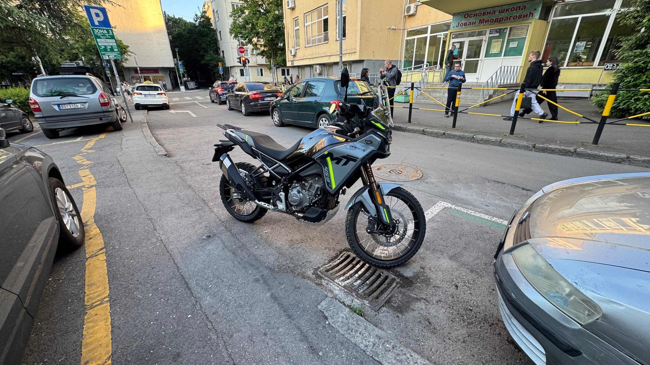

Max_Afrikanac 74 Napisano Maj 18 U prolazu, 39 postova Lokacija: Beograd Prijavi odgovor kao problematičan 4 Citat Podeli ovaj odgovor sa prijateljima Link to post Share on other sites More sharing options...

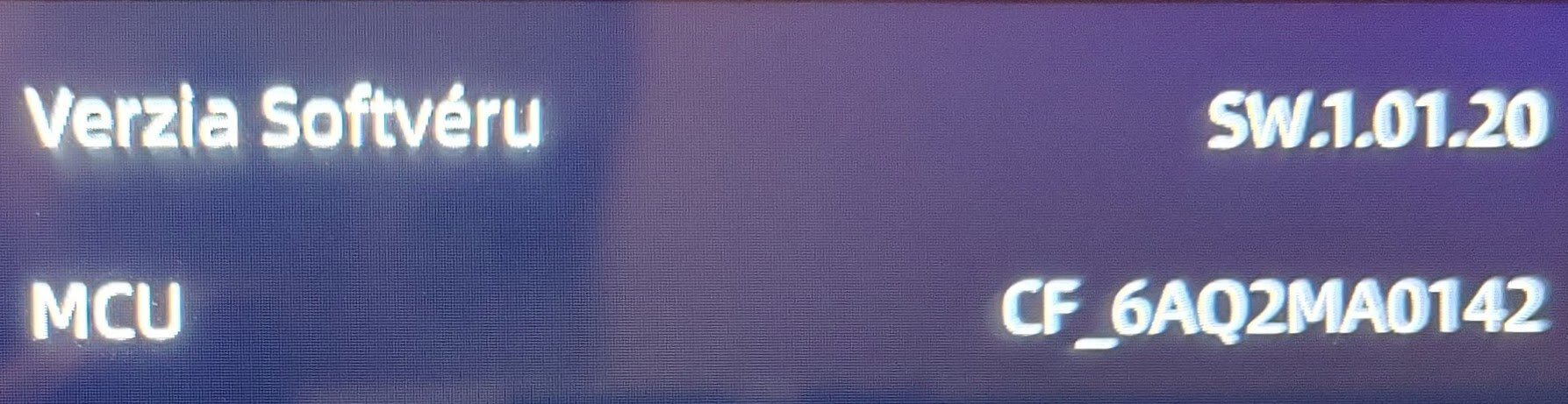

Primitivac 5 Napisano Maj 18 U prolazu, 6 postova Lokacija: Zrenjanin Motocikl: Cfmoto mt450 Prijavi odgovor kao problematičan Jel neko probao? Kopirano sa nekog foruma: I updated the software on my 450MT from SW 1.00.98 to 1.01.20 and honestly, it feels like a completely different bike. All the low-speed jerkiness is gone and the throttle response is now much smoother and more predictable. This started when my partner bought a 2026 model. When I rode it home, I immediately noticed how different it felt compared to my 2025. No jerkiness at all, much smoother overall, and the whole bike actually felt more premium. When I got home, I compared the software versions: * Mine: SW 1.00.98 * Hers: SW 1.01.18 I then updated mine over WiFi to SW 1.01.20. The MCU version was also updated from 127 to 142. The difference after the update is huge. This is without a doubt the best modification I’ve ever done to any motorcycle — and at the same time the cheapest SW = the main engine control software that manages things like throttle response and fueling. MCU = the internal firmware version of the control unit itself (similar to a computer’s BIOS). 1 Citat Podeli ovaj odgovor sa prijateljima Link to post Share on other sites More sharing options...
markommarko 1595 Napisano Maj 18 Drug član, 645 postova Lokacija: Beograd Motocikl: Honda NX 500 Prijavi odgovor kao problematičan Pre 2 sati, Max_Afrikanac je napisao: Komšija 1 Citat Podeli ovaj odgovor sa prijateljima Link to post Share on other sites More sharing options...
roar 428 Napisano Maj 18 Go BIG or Go home, 453 postova Lokacija: Zemun Motocikl: 450 MT Prijavi odgovor kao problematičan pre 41 minuta, Primitivac je napisao: Jel neko probao? Kopirano sa nekog foruma: I updated the software on my 450MT from SW 1.00.98 to 1.01.20 and honestly, it feels like a completely different bike. All the low-speed jerkiness is gone and the throttle response is now much smoother and more predictable. This started when my partner bought a 2026 model. When I rode it home, I immediately noticed how different it felt compared to my 2025. No jerkiness at all, much smoother overall, and the whole bike actually felt more premium. When I got home, I compared the software versions: * Mine: SW 1.00.98 * Hers: SW 1.01.18 I then updated mine over WiFi to SW 1.01.20. The MCU version was also updated from 127 to 142. The difference after the update is huge. This is without a doubt the best modification I’ve ever done to any motorcycle — and at the same time the cheapest SW = the main engine control software that manages things like throttle response and fueling. MCU = the internal firmware version of the control unit itself (similar to a computer’s BIOS). Ovo me vrlo interesuje, prilicno je nezgodno za voznju po Beogradu... Citat Podeli ovaj odgovor sa prijateljima Link to post Share on other sites More sharing options...
Primitivac 5 Napisano Maj 18 U prolazu, 6 postova Lokacija: Zrenjanin Motocikl: Cfmoto mt450 Prijavi odgovor kao problematičan Pre 2 sati, roar je napisao: Ovo me vrlo interesuje, prilicno je nezgodno za voznju po Beogradu... Ja nisam u srb pa ne mogu da proverim za update. Vec sam se navikao i ne primecujem vise to cimanje, ali sigurno da bih se lako navikao na bolje 1 Citat Podeli ovaj odgovor sa prijateljima Link to post Share on other sites More sharing options...
mandrak_ 354 Napisano Maj 19 Svrati ponekad, 211 postova Lokacija: Banat, Vojvodina Motocikl: '25 CFMOTO 450 MT Prijavi odgovor kao problematičan Pre 11 sati, roar je napisao: Ovo me vrlo interesuje, prilicno je nezgodno za voznju po Beogradu... Verzija softvera ne utice na mapu gasa, proverite koju imate verziju MCU, to je mapa ubrizgavanja. Ja sam primetio drugacije ponasanje tek posle azuriranja MCU. To se azurira samo ako motor ima TBOX ili prilikom servisa u ovlascenom servisu. 2 1 Citat Podeli ovaj odgovor sa prijateljima Link to post Share on other sites More sharing options...
