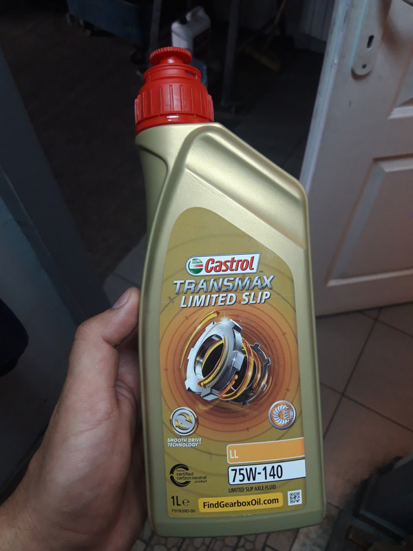

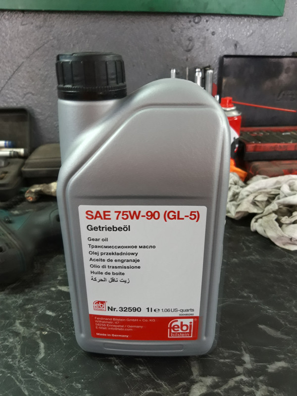

shoyyka 11874 Napisano Avgust 12, 2025 Ne silazi, 3681 postova Lokacija: Arandjelovac-Darosava Motocikl: Džies Prijavi odgovor kao problematičan Koje ulje sipate u menjač/diferencijal? Hvale ovo: Mada bih ja ovo probao: Citat Podeli ovaj odgovor sa prijateljima Link to post Share on other sites More sharing options...

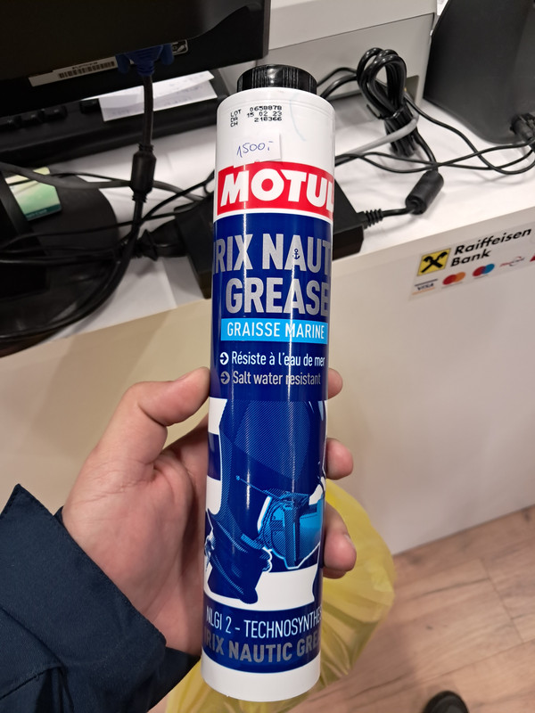

the_doctor 10673 Napisano Avgust 12, 2025 Drug član, 1064 postova Lokacija: Novi Beograd Motocikl: BMW R1200 GS - 2006 K25 Prijavi odgovor kao problematičan Menjač, ovo: Zadnji dif, 180ml menjam svaki mali servis, ovo: Nutove na kardanu mažem takodje svaki mali servis ovim: 25000km sve radi besprekorno...pu pu. Citat Podeli ovaj odgovor sa prijateljima Link to post Share on other sites More sharing options...
Libero 2294 Napisano Avgust 12, 2025 (promenjeno) MiNistrY oF SillY WaLkS, 2155 postova Prijavi odgovor kao problematičan Limited slip ulja nisu odgovarajuća. For the BMW R1200GS (both air/oil and water-cooled models) final drive, the recommended oil is a 75W-90 GL-5 gear oil. While some riders might prefer a specific brand like Castrol Syntrax or Motul Gear 75W90, the key is to ensure it's a GL-5 rated gear oil without limited-slip (LS) additives. BMW's own Hypoid gear oil, often designated as G3, also meets these specifications. Elaboration: GL-5 Rating: The API GL-5 rating indicates the oil is suitable for hypoid gears, which are common in motorcycle final drives and require high-pressure lubrication. No Limited-Slip Additives: The R1200GS does not have a limited-slip differential, so oils containing LS additives are not necessary and could potentially cause issues. 75W-90 Viscosity: This is the recommended viscosity for both the transmission and final drive on the R1200GS, according to BMW specifications. Promenio Avgust 12, 2025 član Libero 1 Citat Podeli ovaj odgovor sa prijateljima Link to post Share on other sites More sharing options...
the_doctor 10673 Napisano Avgust 12, 2025 Drug član, 1064 postova Lokacija: Novi Beograd Motocikl: BMW R1200 GS - 2006 K25 Prijavi odgovor kao problematičan Onomad kad sam uzeo GS-a, slao odma dif kod Rauša u Kraljevo da ga servisira. Tad ga pitao za ovo ulje, dao zeleno svetlo i predložio zamenu za svaki mali servis. Nisam mnogo pitao, peglam tako. Nemam nikakvih problema. Citat Podeli ovaj odgovor sa prijateljima Link to post Share on other sites More sharing options...
Libero 2294 Napisano Avgust 12, 2025 MiNistrY oF SillY WaLkS, 2155 postova Prijavi odgovor kao problematičan Ok, ako tako smatraš onda je u redu. 1 Citat Podeli ovaj odgovor sa prijateljima Link to post Share on other sites More sharing options...

jancha 36 Napisano Avgust 13, 2025 U prolazu, 66 postova Lokacija: Srem Motocikl: Honda NC750X, BMW 1200gs Prijavi odgovor kao problematičan 17 hours ago, the_doctor said: Onomad kad sam uzeo GS-a, slao odma dif kod Rauša u Kraljevo da ga servisira. Tad ga pitao za ovo ulje, dao zeleno svetlo i predložio zamenu za svaki mali servis. Nisam mnogo pitao, peglam tako. Nemam nikakvih problema. Ne ne u pravu su, poslusaj ih, mora GL5, ako je Castrol ide ovo "Castrol MTX Full Synthetic 75W-140" a ne limited slip 1 Citat Podeli ovaj odgovor sa prijateljima Link to post Share on other sites More sharing options...
Немања 2549 Napisano Avgust 14, 2025 Drug član, 931 postova Lokacija: Велика Плана Motocikl: Xciting 500-Tdm 900-Версис 1000-GS1200 Prijavi odgovor kao problematičan Шојка, не чачкај пуно око мотора него вози и само вози и редовно одржавај и то је то…Ја за нутове користим Клубер маст, и успео сам само на једно место да нађем а то је Ексино фирма… за мењач и деф. користим 75-90 ГЛ5 и то је то.. На почетку сваке сезоне одрадим замену уља у кочницама, да будем миран…за гуму кардана мешам две врсте масти, једна и друга су водоотпорне са тим да једна је баш лепљива, намажем лепо и ‘закључам’ гуму, да све то налегне како треба, вишак обришем и све је пицикато… 1 Citat Podeli ovaj odgovor sa prijateljima Link to post Share on other sites More sharing options...
