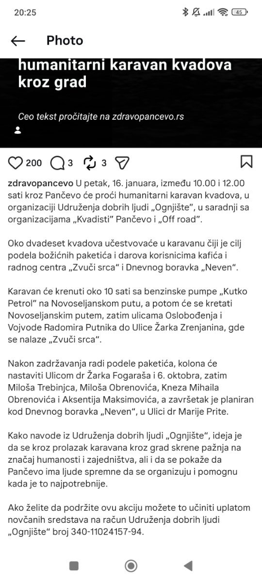

  8. Zdravo Pančevo (@zdravopancevo) • Instagram photo WWW.INSTAGRAM.COM 200 likes, 3 comments - zdravopancevo on January 12, 2026: "U petak, 16. januara, između 10.00 i 12.00 sati kroz...
