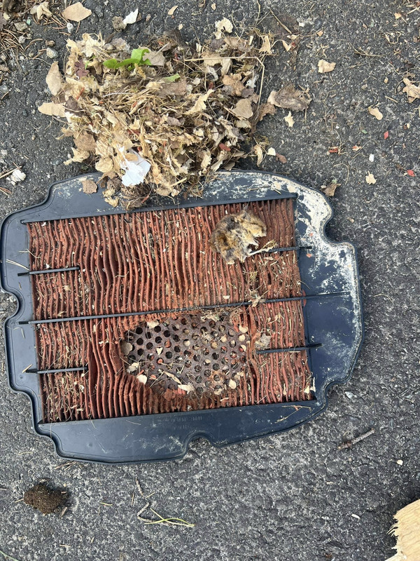

Desmo 3552 Napisano Jun 22, 2024 Drug član, 1501 postova Lokacija: Caltavuturo Motocikl: Air cooled flat six Prijavi odgovor kao problematičan On 11/15/2022 at 5:00 PM, Desmo said: VFR i problemi Vfr problemi 2: "Had a strange crash on track. Seemed like the bike wasn't giving steady throttle and I was spinning out. Maybe the machinist shouldn't have used my air filter box as a home " Citat Podeli ovaj odgovor sa prijateljima Link to post Share on other sites More sharing options...
