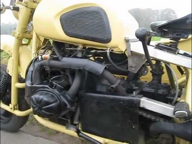

Agregat koji su voleli moto entuzijasti
CYBERMOTORCYCLE.COM
Vintage, Veteran and Classic Motorcycles at Sheldons EMU
sddefault.jpg?sqp=-oaymwEmCIAFEOAD8quKqQ
images_Archiv_Fahrberichte_Dnepr_Dnepr-2
