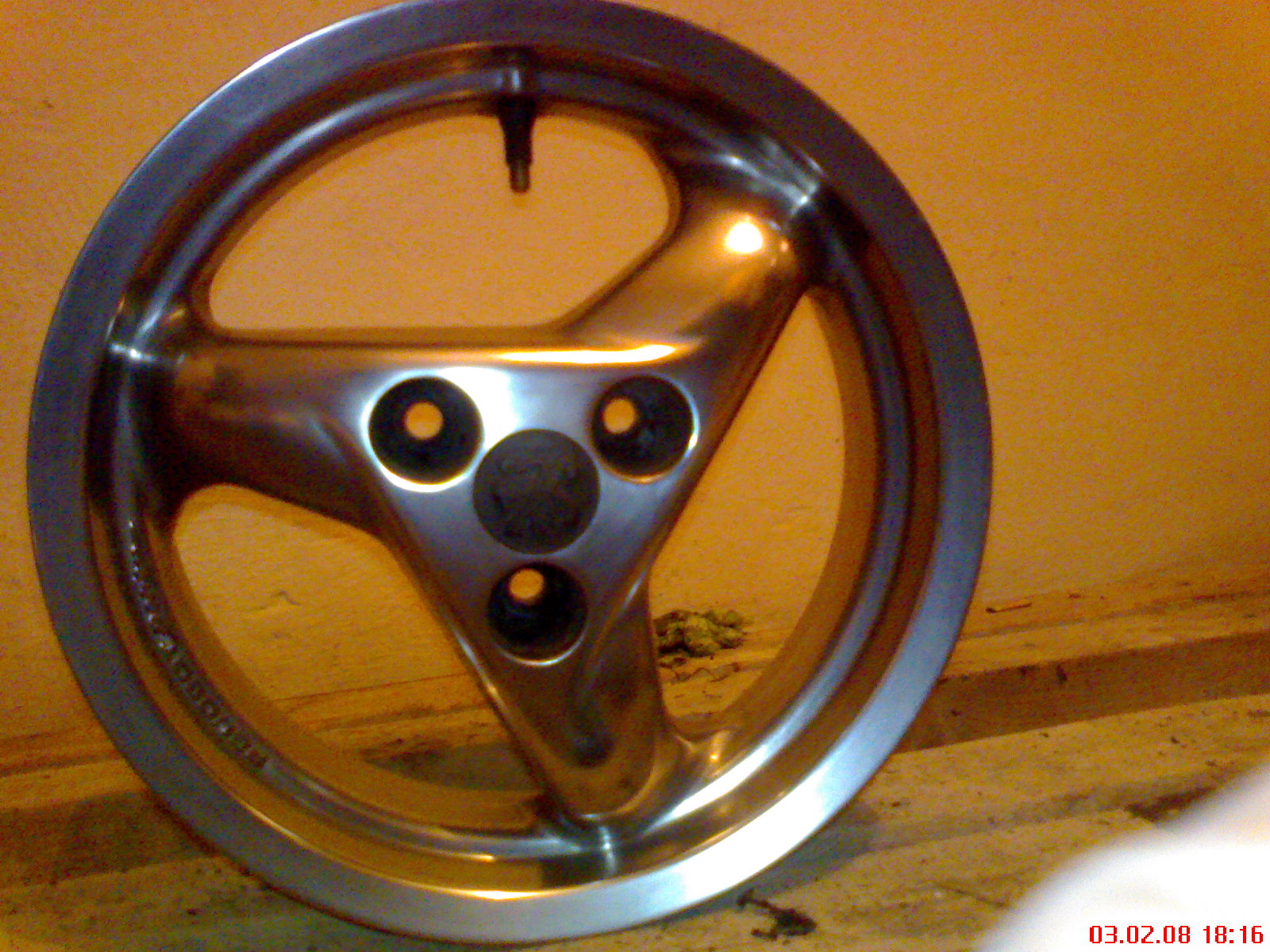

Don Pablo Eskobar 8 Napisano Avgust 2, 2011 U prolazu, 44 postova Motocikl: Keeway Matrix 50 Prijavi odgovor kao problematičan nasao negde na net pa reko da postavim, extra je!! Znaci sledeci materijal je potreban: skid boja (za skidanje farbe) nitro razredjivac(moze i ne mora), ja sam ga malo koristio za ciscenje felne purol pasta-pasta za poliranje grube smirgle (60,120,180,220,280,400) i vodobrusne (600,800,1000,1500,2000) za skidanje farbe je dobro kupiti nastavke za busilicu(kao celicna cetka) raznih oblika evo i slika>>>>>> serijska felna http://7.hidemyass.com/ip-1/encoded/Oi8vaW1hZ2VzaGFjay51cy9waG90by9teS1pbWFnZXMvMjIwL2ZlbG5lMDA0cmEzLmpwZy8%3D prvo skidanje farbe http://7.hidemyass.com/ip-1/encoded/Oi8vaW1hZ2VzaGFjay51cy9waG90by9teS1pbWFnZXMvMjQ2L2ZlbG5lMDAxcXYyLmpwZy8%3D http://7.hidemyass.com/ip-1/encoded/Oi8vaW1hZ2VzaGFjay51cy9waG90by9teS1pbWFnZXMvMjQ2L2ZlbG5lMDAxcXYyLmpwZy8%3D predjeno sa dve grube smirgle http://7.hidemyass.com/ip-1/encoded/Oi8vaW1hZ2VzaGFjay51cy9waG90by9teS1pbWFnZXMvNDAyL2ZlbG5lMDA1a283LmpwZy8%3D predjeno sa jos dve grube smirgle http://7.hidemyass.com/ip-1/encoded/Oi8vaW1hZ2VzaGFjay51cy9waG90by9teS1pbWFnZXMvMjI5L2ZlbG5lcGIwLmpwZy8%3D http://7.hidemyass.com/ip-1/encoded/Oi8vaW1hZ2VzaGFjay51cy9waG90by9teS1pbWFnZXMvMTMyL2ZlbG5lMDA3aXEyLmpwZy8%3D predjeno sa svim grubim smirglama http://7.hidemyass.com/ip-1/encoded/Oi8vaW1hZ2VzaGFjay51cy9waG90by9teS1pbWFnZXMvMTI1L2ZlbG5lMDA4bmQ2LmpwZy8%3D predjeno sa svim vodobrusnim smirglama http://7.hidemyass.com/ip-1/encoded/Oi8vaW1hZ2VzaGFjay51cy9waG90by9teS1pbWFnZXMvMjE1L2ZlbG5lMDEwZ3ExLmpwZy8%3D http://7.hidemyass.com/ip-1/encoded/Oi8vaW1hZ2VzaGFjay51cy9waG90by9teS1pbWFnZXMvMjMxL2ZlbG5lMDExYXo3LmpwZy8%3D ispolirana felna uvece pod svetlom, a ipak se sija http://cdn.bjbikers.com/images/imported/Yw/aSu6A_dsc00138qx9.jpg ta ista felna samo danju (bese oblacno) http://cdn.bjbikers.com/images/404.jpg te iste felne, na suncu http://7.hidemyass.com/ip-1/encoded/Oi8vaW1hZ2VzaGFjay51cy9waG90by9teS1pbWFnZXMvMjMwL2ZlbG5lMDEyZ2Y1LmpwZy8%3D http://7.hidemyass.com/ip-1/encoded/Oi8vaW1hZ2VzaGFjay51cy9waG90by9teS1pbWFnZXMvMjIxL2ZlbG5lMDE1cmk1LmpwZy8%3D sedam dana posla i puno, puno strpljenja!!! i posle... :moto3: Citat Podeli ovaj odgovor sa prijateljima Link to post Share on other sites More sharing options...
bobangsxr 1384 Napisano Avgust 2, 2011 Drug član, 1140 postova Lokacija: cuprija- basel Motocikl: Aprilia SL 1000 Falco - Honda XL 1000 Varadero - Yamaha XVS 1300 Midnight Star-Yamaha Xcity 250-Yamaha Xmax 125 Prijavi odgovor kao problematičan Lepo si poceo ali nisi dovrsio posao. Purol pasta nije bas dobra za te stvari, kad je dobro izpolirano treba da se ogledas u felnu kao u ogledalo i jos samo da ti kazem da rucno neces nikad da uradis to sto treba da se uradi bas kako treba PS, sad videh da ovo nisi ti radio, ali sve jedno je, ovo ne valja Citat Podeli ovaj odgovor sa prijateljima Link to post Share on other sites More sharing options...
MilanPA 22 Napisano Avgust 2, 2011 U prolazu, 64 postova Motocikl: Suzuki an125 Prijavi odgovor kao problematičan U svakom slucaju kao cheep varijanta nije lose, vec sam vidjao ovo. Ali naravno, nije nikako to to. Citat Podeli ovaj odgovor sa prijateljima Link to post Share on other sites More sharing options...
Don Pablo Eskobar 8 Napisano Avgust 2, 2011 U prolazu, 44 postova Motocikl: Keeway Matrix 50 Prijavi odgovor kao problematičan nema pasta, samo smirglanje. moj drug je to uradio i extra mu je ispalo i na kraju je motor prodao 2000 eura, yamahu 50cc. kakve su mu bile felne, ovo je extra ispalo!! to cu i ja preko zime... Citat Podeli ovaj odgovor sa prijateljima Link to post Share on other sites More sharing options...
Don Pablo Eskobar 8 Napisano Avgust 2, 2011 U prolazu, 44 postova Motocikl: Keeway Matrix 50 Prijavi odgovor kao problematičan nema tu poliranja, samo smirglanje. 7 dana smirglanja i smirglanja i smirglanja... pise da treba purol pasta ili moj drug je nije koristio, samo je smirglao. Citat Podeli ovaj odgovor sa prijateljima Link to post Share on other sites More sharing options...
smedic 413 Napisano Avgust 2, 2011 Member Title, 254 postova Lokacija: Novi Sad Motocikl: R1300 GS ADV Prijavi odgovor kao problematičan Kako smirgla 60? Ima da napravi riseve samo takve... Citat Podeli ovaj odgovor sa prijateljima Link to post Share on other sites More sharing options...
Don Pablo Eskobar 8 Napisano Avgust 2, 2011 U prolazu, 44 postova Motocikl: Keeway Matrix 50 Prijavi odgovor kao problematičan i ja sam mislio ali nije, felne koje je drug uradio ispale su kao na slici mozda i bolje... Citat Podeli ovaj odgovor sa prijateljima Link to post Share on other sites More sharing options...
Mare70a 1415 Napisano Avgust 2, 2011 veloce come un proiettile , 728 postova Lokacija: Beograd Motocikl: Vespa Gts Super 300 Prijavi odgovor kao problematičan Jedno pitanje, Kada se dodje do onog pravog zeljenog efekta,ko pasija m..a da kazem,da li tada postoji shansa da se to izlakira nekim bezbojnim lakom i zastiti od oksidacije? Citat Podeli ovaj odgovor sa prijateljima Link to post Share on other sites More sharing options...
bosske 67 Napisano Avgust 2, 2011 U prolazu, 67 postova Lokacija: Beograd, medakovic Prijavi odgovor kao problematičan na zalost nema lak koji ide direktno na aluminijum, imaju u stvari neki lakovi ali mislim da su toliko skupi da ih niko kod nas ne uvozi. Mislim da je mnogo laksa varijata uzeti grom boju i prefarbati felne pa lakirati, mnogo manje posla, duzi efekat ostaje, i daleko i jeftinije izadje. ovo jete lijepo i imaju paste za poliranje aluminijuma, ali to poliranje traje neko vrijeme i potamni i izgubi sjaj, a ogroman posao je u pitanju. Citat Podeli ovaj odgovor sa prijateljima Link to post Share on other sites More sharing options...
Don Pablo Eskobar 8 Napisano Avgust 3, 2011 U prolazu, 44 postova Motocikl: Keeway Matrix 50 Prijavi odgovor kao problematičan 7 dana mukotrpnog smirglanja!! ako se stavi pasta ili lak onda gubi sjaj i boju, najbolje je nista ne stavljati jer aluminiju ne oksidira i trebalo bi tako ostanut. tako nauka kaze... Citat Podeli ovaj odgovor sa prijateljima Link to post Share on other sites More sharing options...
rboban 1063 Napisano Avgust 3, 2011 Drug član, 3028 postova Lokacija: Obrenovac Motocikl: FZ1S Prijavi odgovor kao problematičan ako je dobro ispolirano ostaje bas dugooo sjajno, dovoljno je malo prepolirati jednom godisnje i to je to..... Citat Podeli ovaj odgovor sa prijateljima Link to post Share on other sites More sharing options...
Don Pablo Eskobar 8 Napisano Avgust 3, 2011 U prolazu, 44 postova Motocikl: Keeway Matrix 50 Prijavi odgovor kao problematičan i onda "ku*cenje" kroz grad... Citat Podeli ovaj odgovor sa prijateljima Link to post Share on other sites More sharing options...
stari roker 4854 Napisano Avgust 3, 2011 motoras, 2621 postova Lokacija: PECINCI Motocikl: BMW '73. zderac kilometara // TOMOS APN 4/deva //Gpz900r Ninja // VULCAN VN1500 Prijavi odgovor kao problematičan Kako smirgla 60? Ima da napravi riseve samo takve... Pa sa 60 pocinjes. Onda prelazis na finije redom dok ne dodjes do ogledalnog sjaja. Kada zavrsis sa 60, predjes na 120 i radis dok se ne "poniste" risovi od 60-tke. Onda uzmes finiju i tako do kraja. Citat Podeli ovaj odgovor sa prijateljima Link to post Share on other sites More sharing options...
bobangsxr 1384 Napisano Avgust 3, 2011 Drug član, 1140 postova Lokacija: cuprija- basel Motocikl: Aprilia SL 1000 Falco - Honda XL 1000 Varadero - Yamaha XVS 1300 Midnight Star-Yamaha Xcity 250-Yamaha Xmax 125 Prijavi odgovor kao problematičan Kako smirgla 60? Ima da napravi riseve samo takve... Pa sa 60 pocinjes. Onda prelazis na finije redom dok ne dodjes do ogledalnog sjaja. Kada zavrsis sa 60, predjes na 120 i radis dok se ne "poniste" risovi od 60-tke. Onda uzmes finiju i tako do kraja. Samo da kazem da ako smirglate rucno ne krecite sa smirglom ispod 120, a masinski moze ladno sa 60 Citat Podeli ovaj odgovor sa prijateljima Link to post Share on other sites More sharing options...
Don Pablo Eskobar 8 Napisano Avgust 3, 2011 U prolazu, 44 postova Motocikl: Keeway Matrix 50 Prijavi odgovor kao problematičan prvo masinski, pa onda rucno. 3 dana je dosta za jednu felnu. najbolji dio je kad dodju vodobrusne... tek onda dobija sjaj. posle njih si moga da se brijes, pravo staklo... Citat Podeli ovaj odgovor sa prijateljima Link to post Share on other sites More sharing options...
