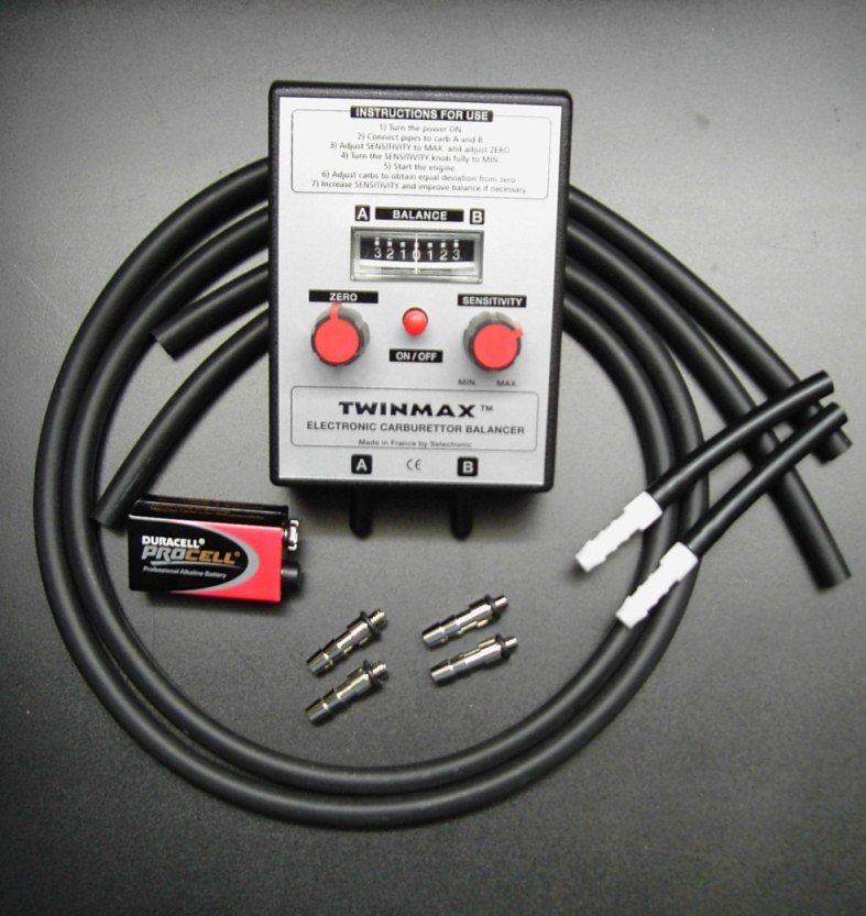

  1. barkocis
    Twinmax
    Tvinmax jedan put koristen. 100e 063426674
