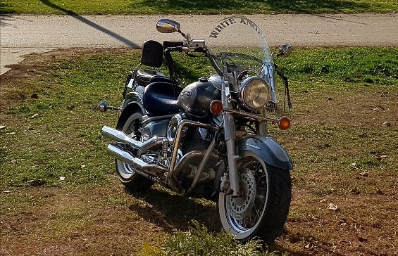

  9. Drag star Xvs1100 2006 clasic i virago xv1100 1992.
